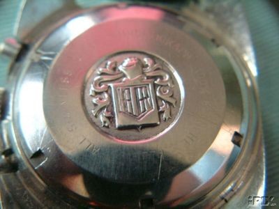

looking good!! until they stamped "Heuer & Leonidas Co." inside the case-back and added those long hands
Heuer and Leonidas on the dial, many years before the merger; awful marks on movement and inside case-back
styling from the 30's or 40's; marked with the "Heuer" and the "Leonidas" (merged in 1964)
another "Heuer Leonidas" dial; the usual crude "Heuer" marking on the movement

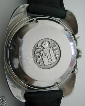

the only "bullhead" bearing the Heuer name?
trying to pass as a Camaro; GMT inner bezel; jewel count on dial; silly looking mark on movement

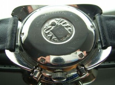

the crown looks OK, the rest is fake; note Ed. Heuer markings on bridge and case
